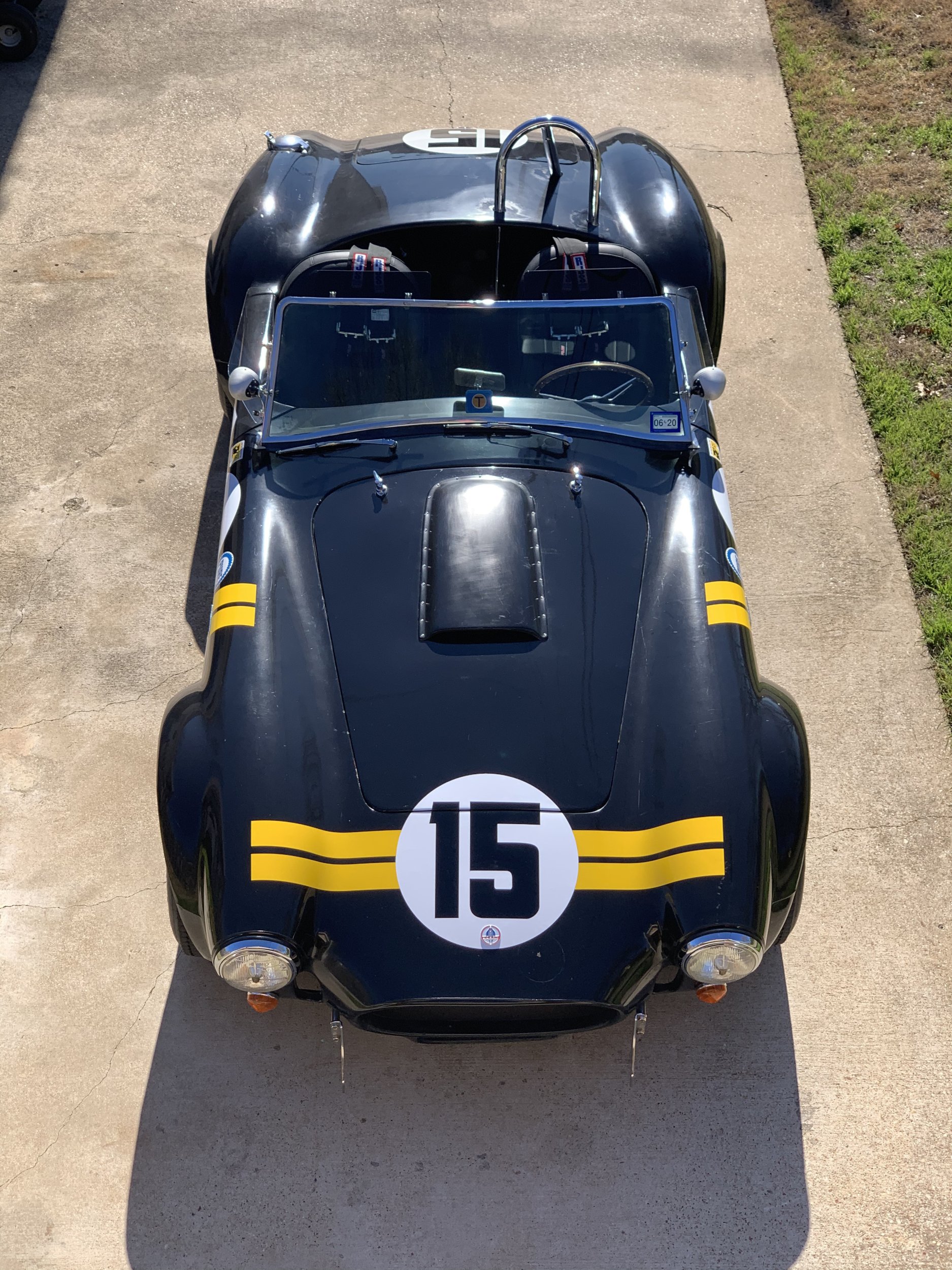

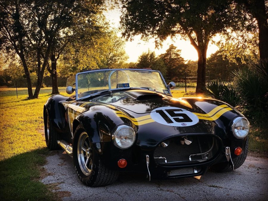

We ordered our cobra kit from Hurricane Motorsports in 2012 and completed the build in 2019.
Front Suspension
Mustang II based, Fully Adjustable QA1 Aluminum Coil-Over Shocks, Unequal Length Tubular Upper & Lower A-Arms, 1-1/8" tubular anti-sway bar
Rear Suspension
Ford 9-inch solid axle, 3.50:1 limited-slip differential, QA1 Aluminum Coil Over Shocks & Adjustable Ride Height, 3-link suspension system with panhard bar, 31 Spline High-strength Axles
Brakes
Front: Wilwood 12.2" Ultralite vented rotors, Wilwood Dynalite 4 piston aluminum calipers
Rear: 12" solid rotors and Ford SVO floating disc calipers
Wheels & Tires
Trigo 427 Cobra 5-pin aluminum period correct wheels - front: 7.5" x 15", rear: 9.5" x 15", hub adapters, tri-wing knockoffs. Goodyear Eagle sportsman "Billboard" tires - front: 26.5 x 8.0-15," rear: 26.5 x 10.5-15"
Color Details
no paint - still in factory black gelcoat! The livery decals are from Race Line Digital, as the 1963 289 Cobra CSX2128 driven by Dan Gurney at Sebring, Florida in 1963
  • added front shock tower support square tube, same as original 427 cobras
  • Fabricated a hidden receiver hitch for towing a cargo trailer

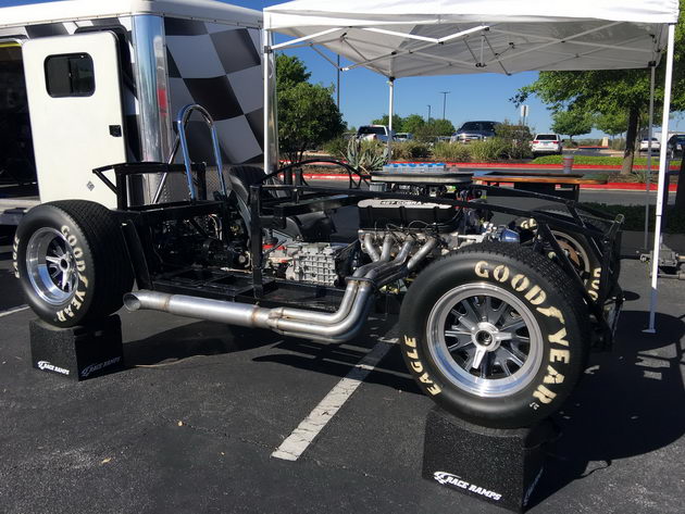

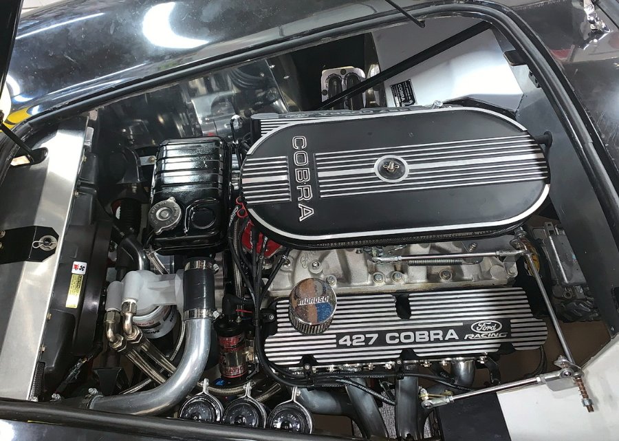

427 cu. in.
Ford 351 Windsor - Dart block
Custom hybrid 4-barrel carburetor from Cobra Valley, consisting of a cast aluminum Holley XP body, 650 cfm, and a Holley 750 cfm base, AED billet metering blocks are in place between stock Holley bowls. Boosters and venturis are contoured, deburred and polished for optimal air flow. Double-pumper / mechanical secondaries.
Edelbrock Performer RPM port-matched intake
Valve Train Details
AFR 205 aluminum heads 75cc
Ignition
MSD Pro Bil1et Distributor, MSD coil, MSD 6AL ignition box
Exhaust
Custom 1-3/4" tube headers from Hurricane Motorsports, side pipes with Classic Chambered 24" x 3" I.D. Cobrapack mufflers, silver ceramic coating
Transmission
Tremec TKO600 5-speed 0.64:1 Overdrive with bronze fork pad kit, carbon synchronizer kit, 2-3 shift rail modification by Texas Drivetrain Performance in Hurst, TX
Our 351W/427 small block Ford engine dyno'ed at 599.6 Horsepower, and 600.5 ft/lbs torque. Completed the original period-correct look by adding FE-style expansion tank modified for SBF, and remote oil filter.
img_8323-jpg.450
Interior Details
Interior Details
To resemble period-correct originality, all gauges are Smiths and toggle switches and knobs are Lucas.
Gauges
S/C dash layout with all Smiths gauges: OEM style all-electronic with 270° sweep counter-clockwise 180mph speedometer, tachometer, oil pressure, oil temperature, water temperature, fuel level and voltmeter.
OEM genuine Lucas toggle switches, ignition switch, wiper knob, dimmer knob.

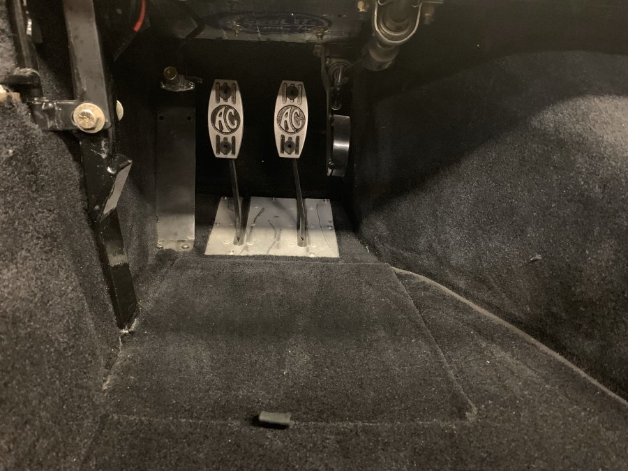

  • designed and built clutch, brake and accelerator pedal setup identical to original cobras.
  • OEM Style custom door pockets and door latch pulls
  • designed and built original style street Cobra glove box with correct pull.
  • LED lighting under dash and inside glovebox
Special Features
  • added Rugged Radio STX Stereo intercom and headsets, for voice activated in-car communication, Bluetooth connectivity to cell phone for streaming music and phone calls, two-way radio ready.
  • Custom tonneau cover matching the racing livery
