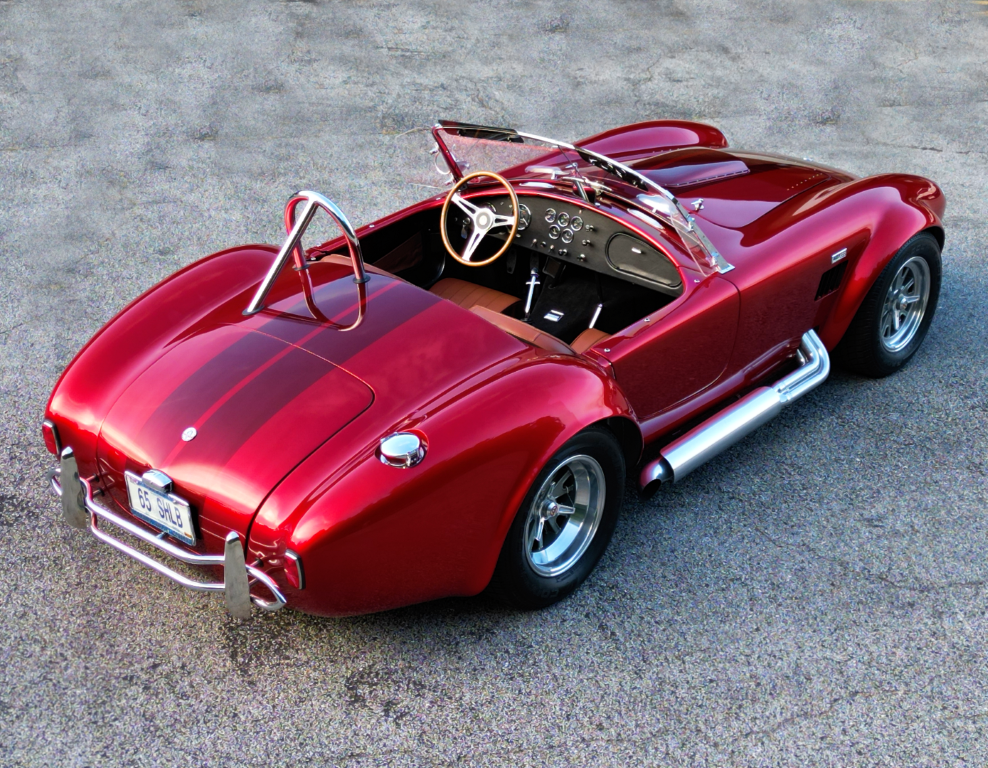

Highly modified Gen. II Hurricane Motorsports build. Engine compartment, hood, firewall, & foot boxes replicate original vehicles.
More Details

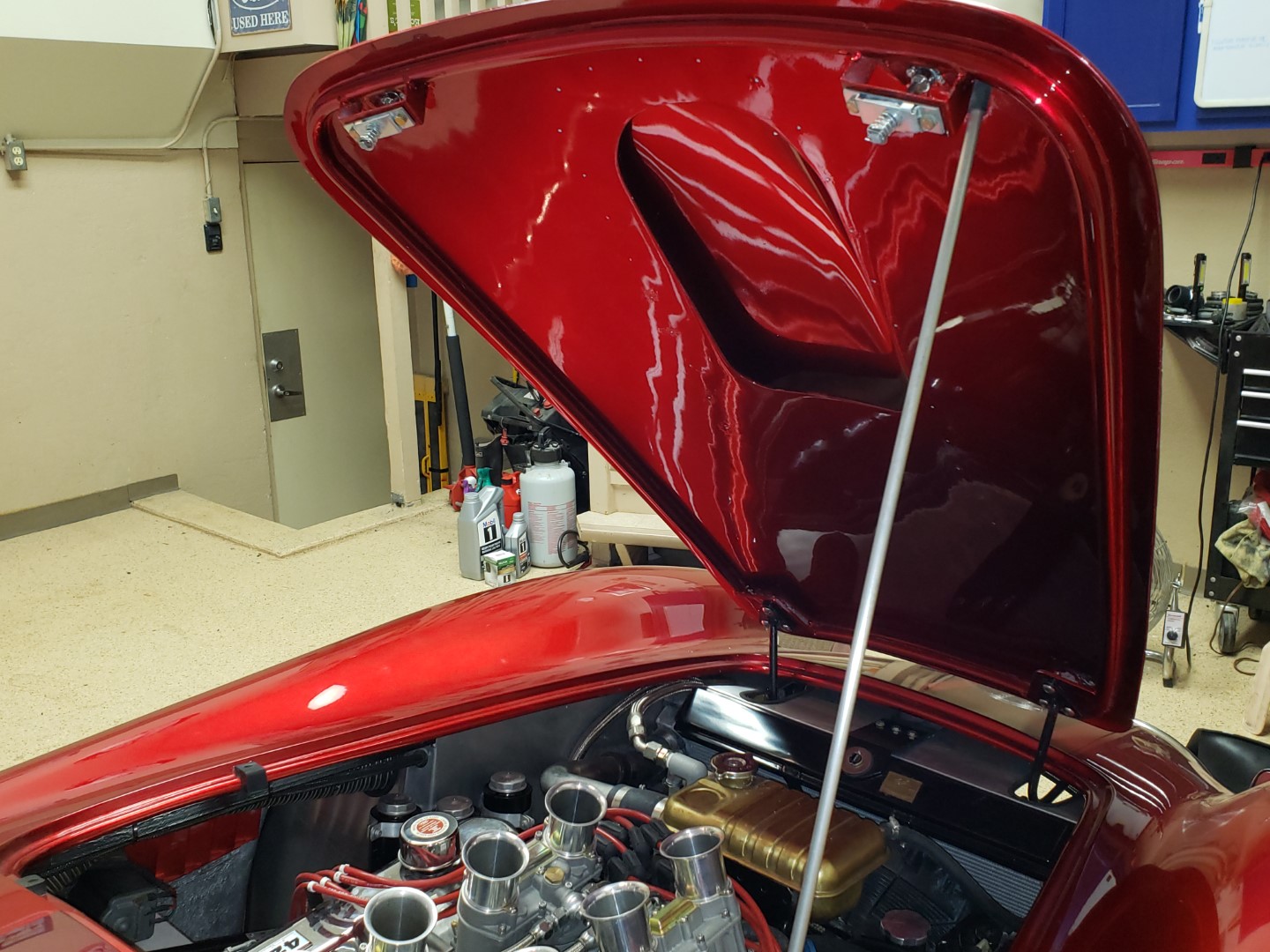

Working with Hurricane Motorsports, I designed and converted a S550 Mustang IRS to fit the Hurricane chassis and to accept 15" pin drive wheels. This car is the prototype of their current production. Once I got the body home, I then went to work modifying the cockpit, firewall, footboxes and engine compartment to replicate a 1965 Shelby. The hood has a replica tube frame with skin, radiator tank and shroud copy the 65's. The rim of the cockpit was rolled to replicate the 3/4" tube frame of the AC body. The Hurricane tunnel was removed and replaced with an aluminum tunnel (ala ERA) and copies the interior of the AC.

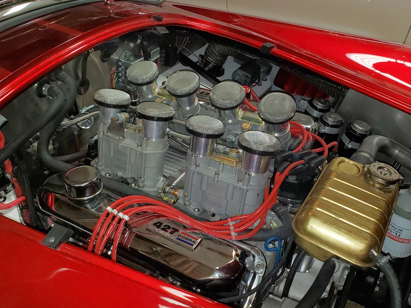

468 Cu. In.
Ford FE - Shelby Aluminum Block
Borla EightStack - Performance Electronics ECU

Harlan Sharp Roller, Custom Hydraulic Roller Cam

Slipfit Headers - Ceramic Sidepipes

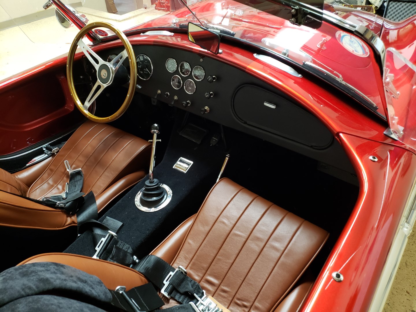

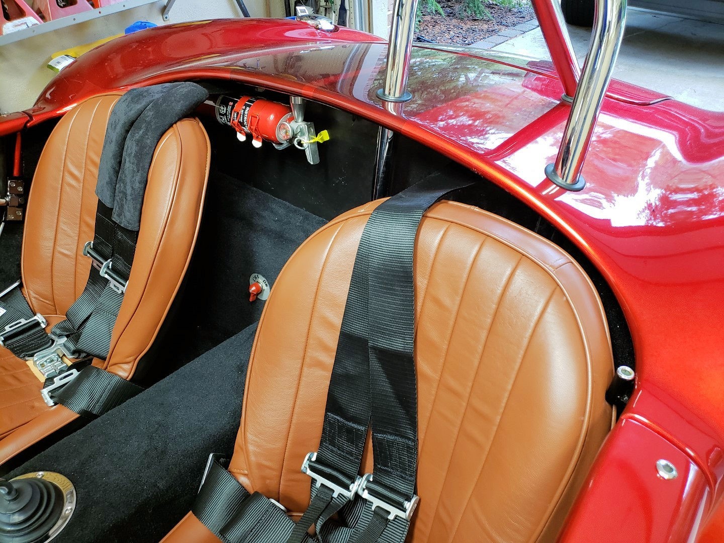

Brunello Leather on Black. Black Wilton Wool carpet. Alum dash w/ rolled edges for steering shaft and glovebox.
Gauges
Smiths

Special attention to Hood frame and skin detail to replicate original car
